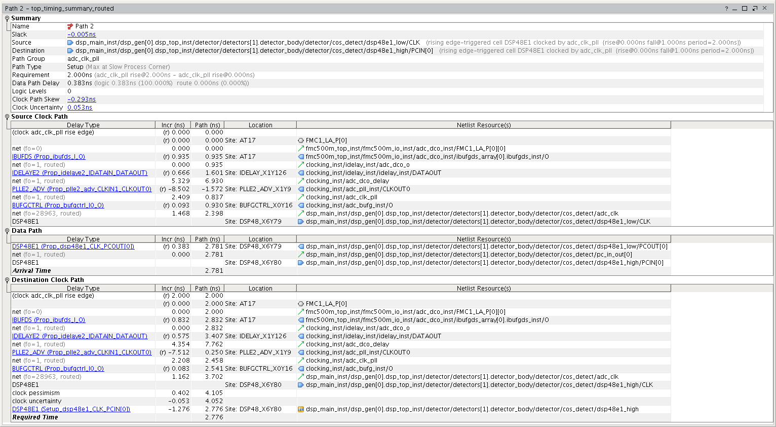

I have the following path failing timing, and I would really appreciate some advice in understanding what I'm seeing here and how to fix it.

2. The failing path is hard-wired internal path between two DSP48E1 units, specifically the MULTSIGN and PC paths; I'm astonished to see a failure here!
3. Placement has decided on this occasion to place the two DSP units on separate clocking tiles (X0Y3 and X0Y4) to my misfortune.

I am quite unfamiliar with how to read the clock path here, and I have to admit to being completely baffled by the fact that although the source and destination paths are identical up to BUFGCTRL_X0Y16 there is already a huge skew (2.541 - 2 - 0.930 = -0.389 if I'm reading this right) -- does this make sense?  I think I understand that there is a -0.306 (1.162-1.468?) routing skew ... but very little else makes much sense to me.  Clearly the signal routing delay itself is tiny (0.383), so my problem is entirely clock skew across clock tiles.
So two questions:
1.How can I usefully understand the path report I'm seeing here?  Which documentation should I be reading?
2.How can I get more information about *why* this problem has arisen and how to resolve it?

In addition, i have to confess that I'm still quite baffled when trying to read the timing report.  I'm guessing my best way to get any further details is to look at UG472?  Am I correct in understanding the edge-to-edge propagation time in my case to be 0.383+1.276 (path delay plus logic and setup time)?
This now seems to add up:
Logic+routing delay = 1.659
Clock skew = 0.293
Clock uncertainty = 0.053
Total edge to edge delay = 2.005 (5ps too late)
So I presume that 293ps is the clock skew between my two regions, and the 53ps uncertainty is jitter.  Do I have any influence whatsoever on these numbers, or are they intrinsic to my device?  Indeed, it is a Virtex-7, a 690 in my case, so I am swimming in DSP slices!
