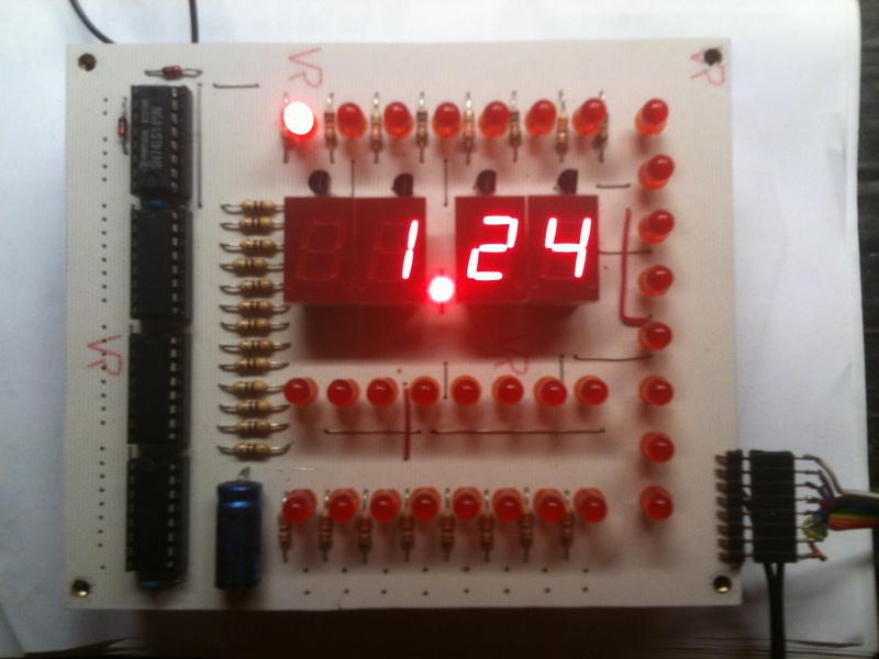

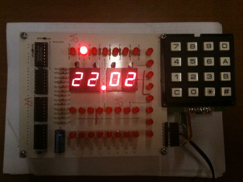

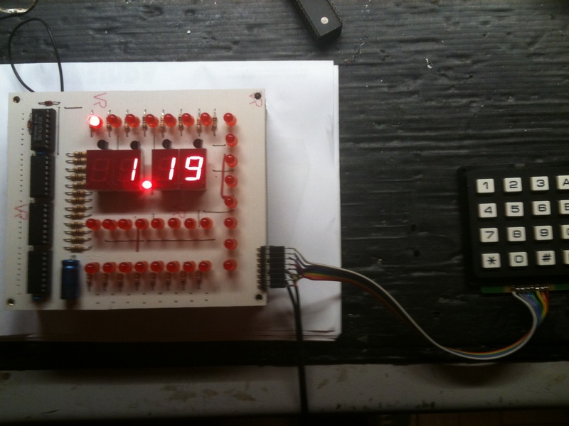

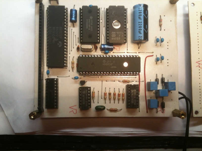

I've written about the eprom file published in the journal rechecking 5 times, this does not run properly and you can not enter or edit the time clock and the 0 key does not work.
I also tried to insert a MC6809EP (test version opcode) driving it with external oscillator but the operation is the same.
there is probably an error on the listing .(There are several bytes to FF and it is possible that the listing has never been verified)
For this reason I am looking for the original eprom file ...
these are some pictures of the circuit

I found the problem and I solved it!
I found the keyboard short-circuit between a column1 and a row 2 !
Now the timer works perfectly and as a result the software is correct!
on request I will send the file 84047-1. bin
