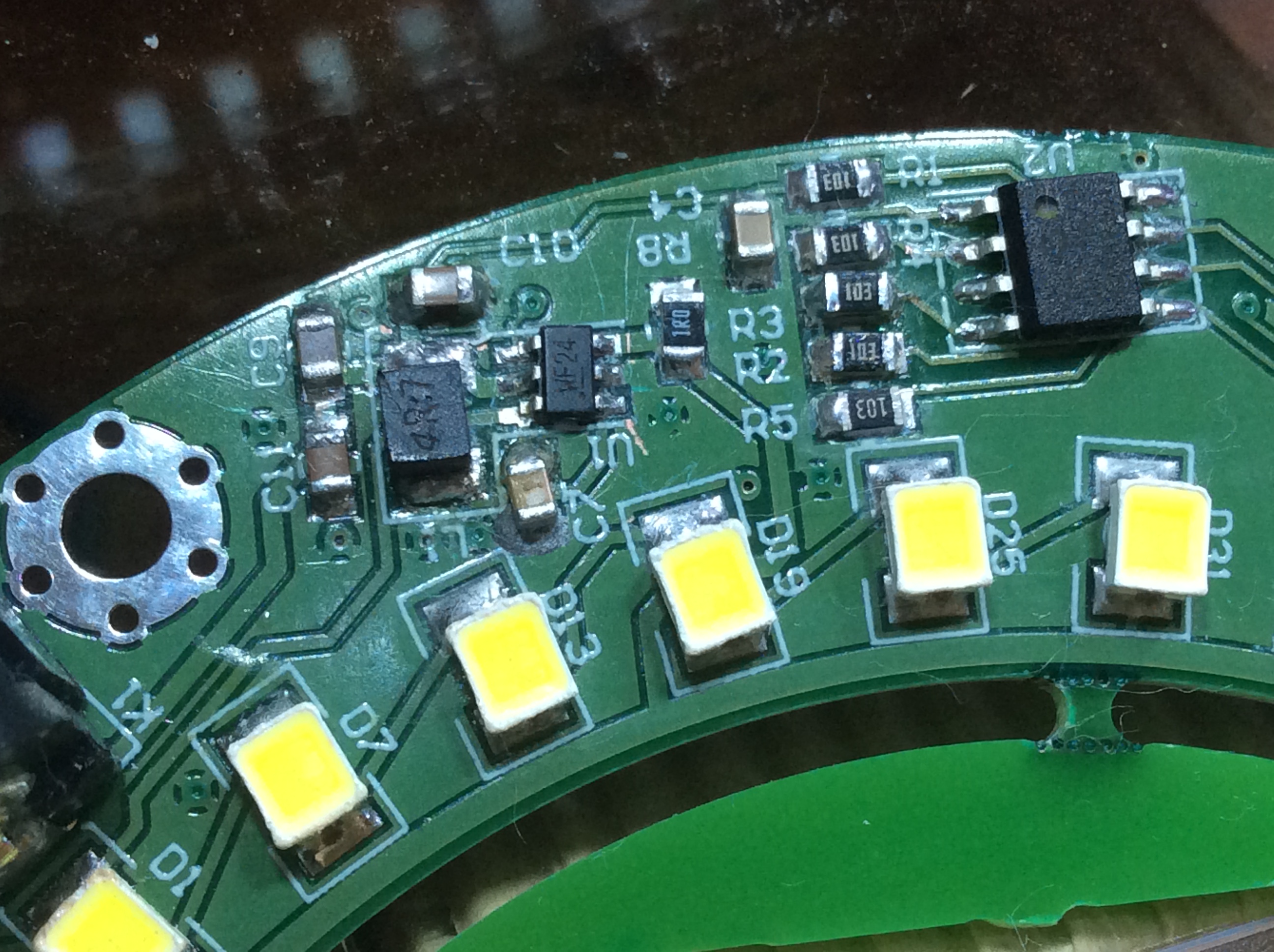

Postby gerritpostma » Mon Jan 05, 2015 9:31 am
Added picture of the mainpart.
C9 maybe connected to C11, but that is to the same wire.
mainpart picture

Re: Labworx 2, Ring light is not working
Postby ag » Mon Jan 05, 2015 5:20 pm
Hi Gerret,
I found at least 3 others who built this ring light who reported problems (in the german forum). The problems appear to have been due to wrong microcode programmed into the PIC12F683. In the following link you can find pictures of the signal on pin 2 of U2 which show the incorrect signal due to the incorrect firmware. If you have an oscilloscope, you should check your pin 2 signal, and if it is similar to that in the pictures, you also have received a PIC12F683 with incorrect firmware. In that case, you might be able to return your ring light to Eurocircuits for a no-cost repair, as at least one customer in the cited link did.

Postby gerritpostma » Sun Jan 18, 2015 7:33 pm
U1: PIC12F683: Ordered a pic adapter and compared the loaded software and software accoording the book. The first 4 bytes were different
U2: MIC3289: replaced with a new one
Used an other adapter with a higher current output; 5V - 2A
Result: the leds give light now (very bright).
-switch 1 for power on/off is working
-switch 4 for memory: ???. Light is out during button is pressed
-switch 2 for light up step: does not work
-switch 3 for light dimming : does not work and light is out during button is pressed
Intermediate result: lights are working. Next step is again investigating PIC12F683
