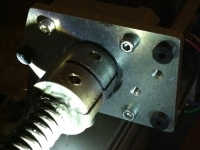

Postby hobby11 » Thu Mar 10, 2011 12:00 am
Sorry !
The X axis is really hard to turn. I can not put the threaded rod correctly. I see that when the rod rotates the ball bearing moving into housing.
Are you tips for set correctly the rod ?
Thanks
Olivier
Hi have checked the space, for me is normal.
I have take photo.
hobby11

Postby hobby11 » Sat Mar 12, 2011 12:00 am
Thanks for your help.
I confirm the problem is the clamp (very low quality).
I search to replace the clamp.
