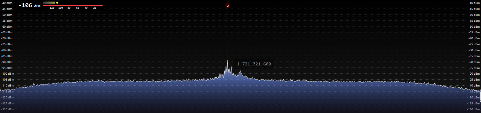

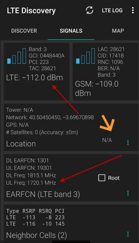

I have this app in my phone which tells me the LTE UL frequency and power so I went with my SDR and measured the received signal at that frequency and it matched.
Now, how can I be sure this is the transmitted signal from my phone? As I made a call to and from this phone and nothing changed.
