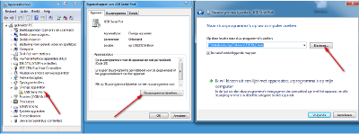

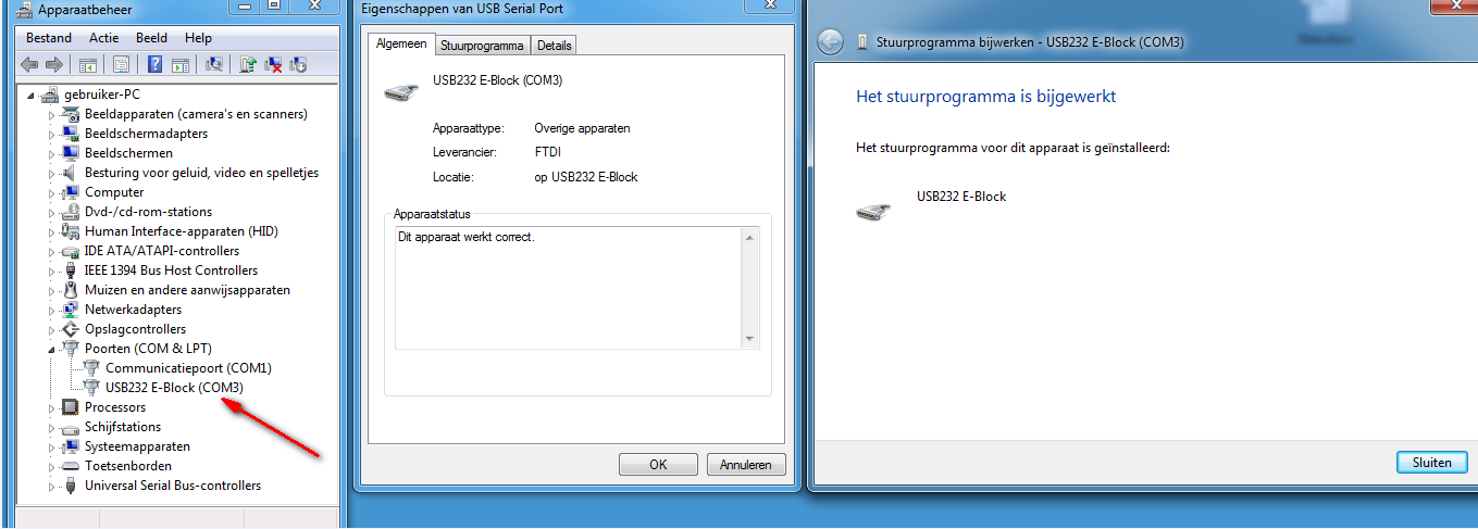

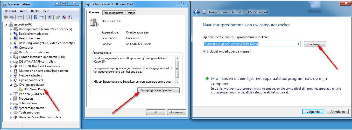

the procedure to install the driver with win7 is a little bit different then discribed in the course.
Go to "configuratiescherm" "apparaatbeheer" connect the EB039 bord on the pc, click (2x) on USB serial port and then you can link to the map with the zip file EB039_sriver.zip
(see also attachements)
Now everything works. The "AAAAA..." appear on the screen

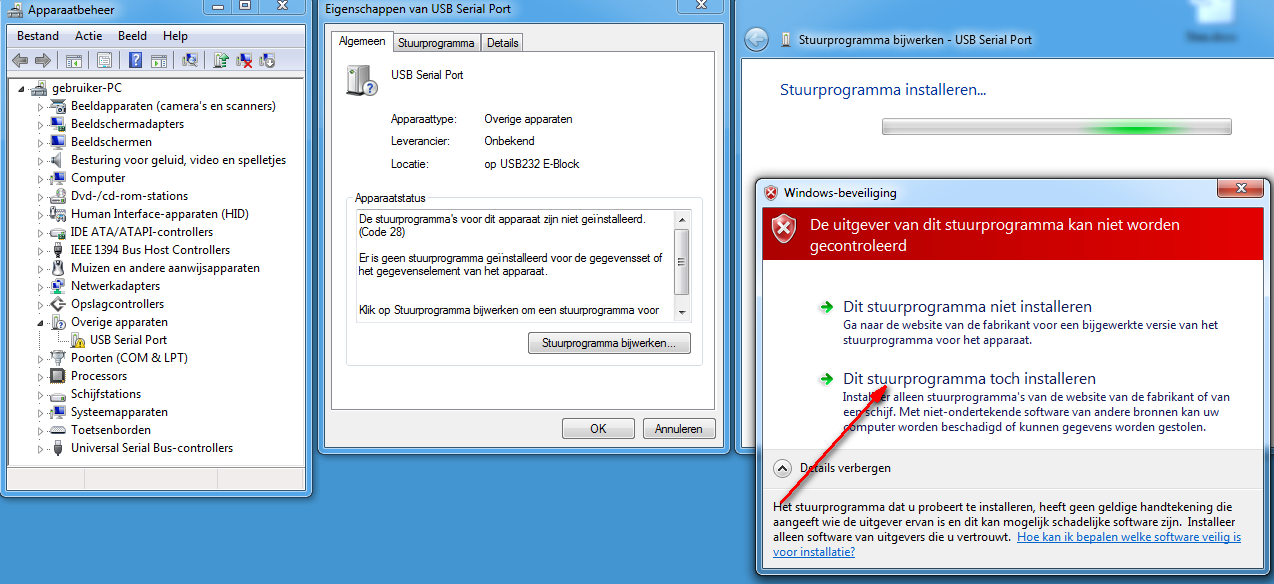

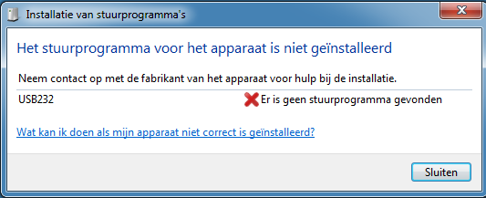

Postby dirk_999 » Sun Nov 13, 2011 12:00 am
The first time I use the EB039 board i had a message (see attachment) the only thing I could do was closing that window. The second time I plugged in the EB039 board i opend first the "apparaatbeheer" window and then i could further.
