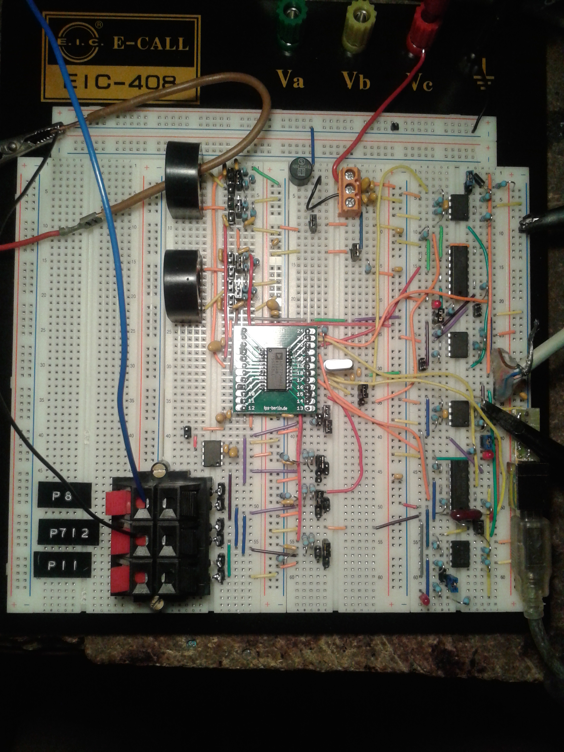

Well, I haven´t given up yet. In the meantime I have gone through about everything the net has to offer regarding this, without making any real breakthrough. Since the evaluation board from Analog Devices is still too expensive for me, I decided to create a breadboard version for only a fraction of the cost. Both the associated calibration program (ADE7754Cal.exe) and evaluation software (ADE7754EVAL r3p1.exe) work on it without any problems (except for the temperature readout being way off). Unfortunately, my expectations on the evaluation software were disappointed. But at least I now have a tested hardware platform with which I can perform tests of my upcoming attempts to do some programming for the ADE7754. I found a few examples for ADE775x devices which I will try to adapt.
As before, any helpful hints are welcome ;)
